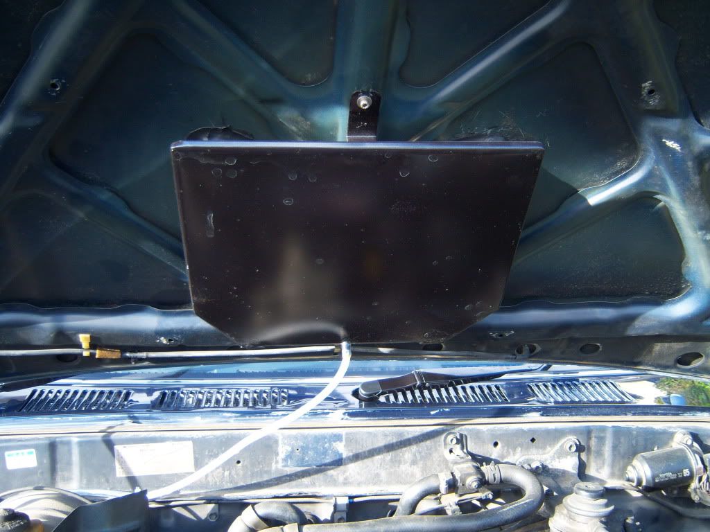

on another note gwh - the water coming through the vents and dribbling all over your electrickery bits. i put a drip tray under mine before it went to vince. its a simple thing to do and im sure vince will take a pic and send it to you.

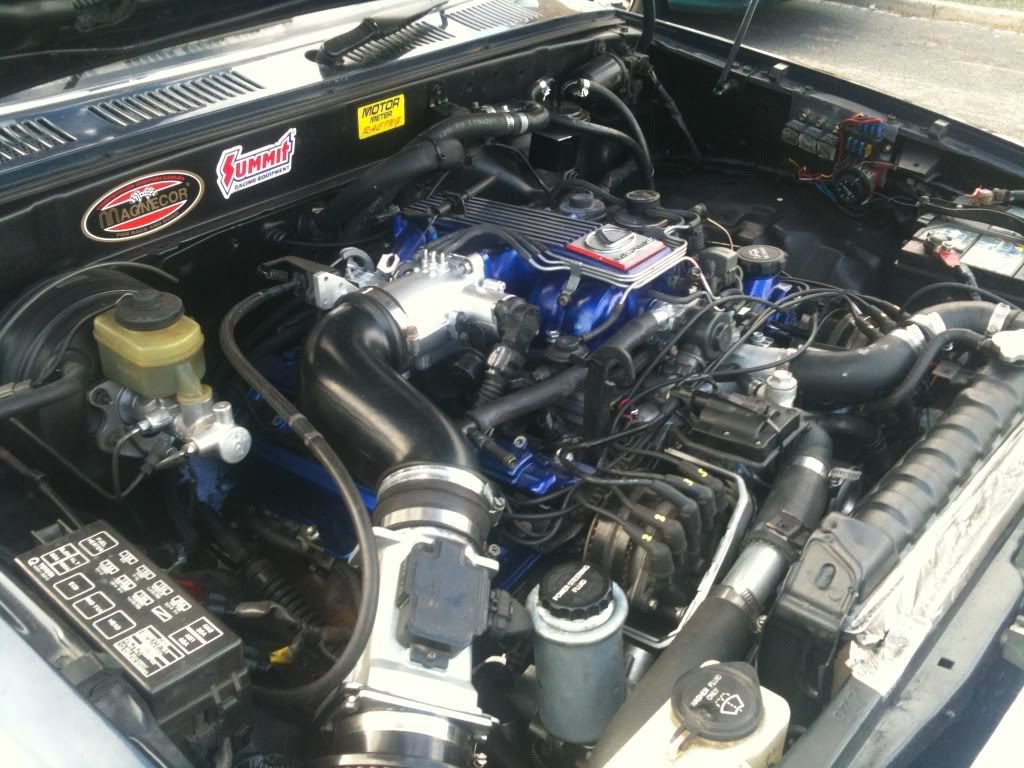

Posted by: gwh200
Date: 30-10-2010 14:43:56

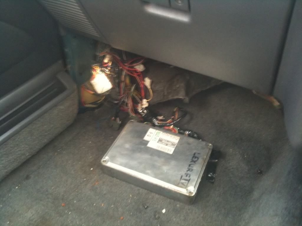

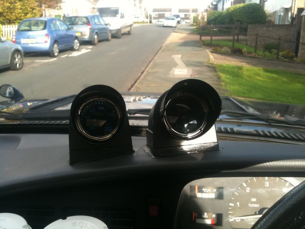

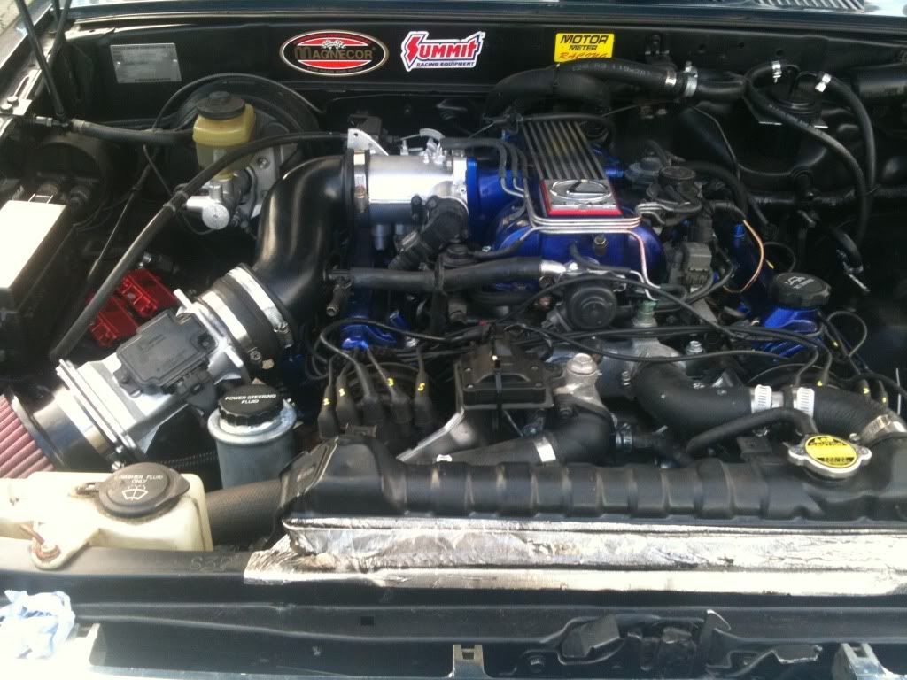

Cheers for your help brian. Sone pics. Will sort vid later.
http://i240.photobucket.com/albums/ff148/gwh200/82f969a2.jpg
http://i240.photobucket.com/albums/ff148/gwh200/276df4b5.jpg
My pods ....
http://i240.photobucket.com/albums/ff148/gwh200/7969976d.jpg
And some wiring...I've had it all out, but I've put it away now. I was fooling the 02 sensor into thinking the cold start injector was connected.
http://i240.photobucket.com/albums/ff148/gwh200/b3242f5a.jpg

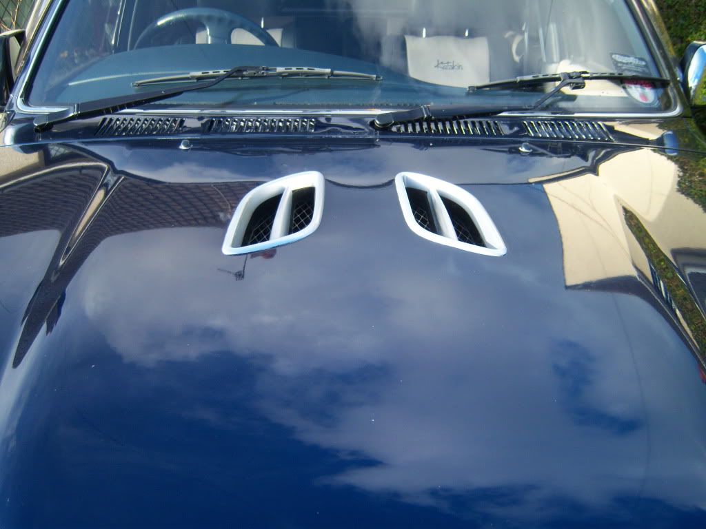

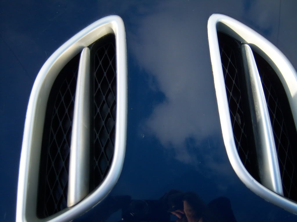

Here you are......
http://i8.photobucket.com/albums/a41/toyosurfer/Picture065-2.jpg
http://i8.photobucket.com/albums/a41/toyosurfer/Picture066-3.jpg
http://i8.photobucket.com/albums/a41/toyosurfer/Picture064-2.jpg
They're MK2 (1999-2002) Nissan Primera bonnet/radiator grilles by the way. :)
