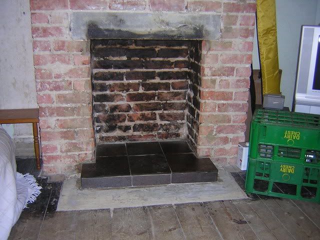

This is what the fire place started as, with a horrid fake gas thing, with horrible pointy bits just right for the dogs or people to catch themselves on. So Corgi man came and took it out, and I found the bit of flamproof material covering a hole. So the next day I took my steel toe caps to it and found this.
http://i210.photobucket.com/albums/bb208/drhysted/DSCN2517.jpg
That horrid block work that surounded the old fir was nailed into the wall, and fell off (onto my boots thank god for steels), the plaster was cracked, so I decided to expose the brick work of the whole chimney, and although it still needs alot of work I like the look.

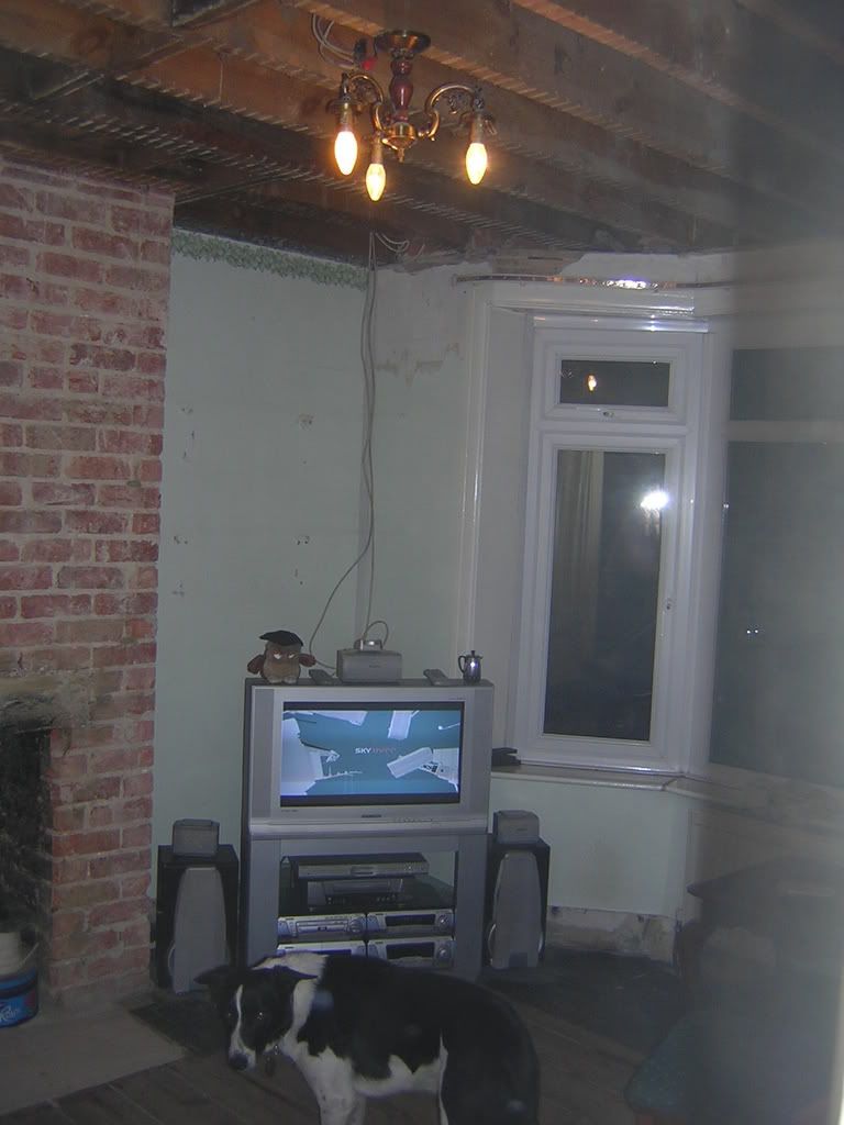

Also the ceiling was craked and I wanted to replace the lighting with something more discreate, so I started to remove the ceiling.
http://i210.photobucket.com/albums/bb208/drhysted/DSCN2526.jpg
During the removal I found an old newspaper dated September 1931, a 9 of spades playing card, and a peice of film negative (which I'm trying to alter with photoshop).
http://i210.photobucket.com/albums/bb208/drhysted/DSCN2525.jpg

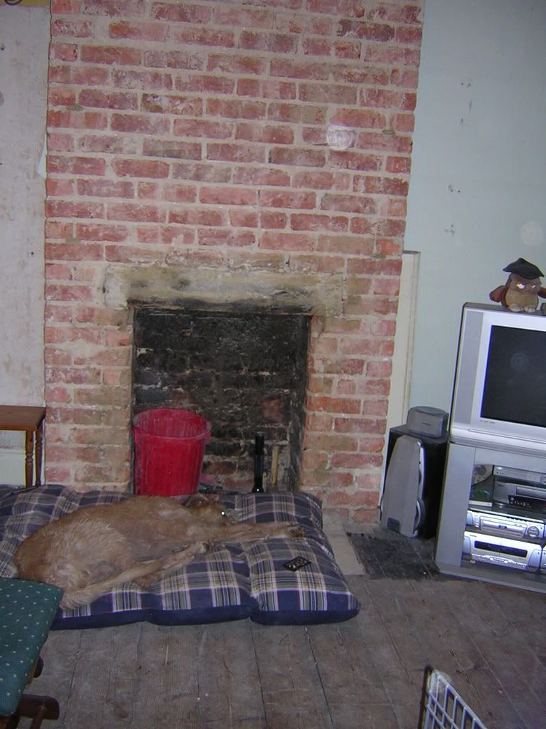

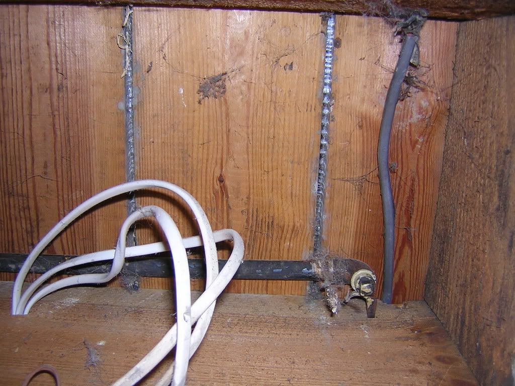

Here we have three different ways of lighting a room. The old gas pipe, old lead electrical cable, and the current stuff.
I need to sort out the fireplace, as I think the rest of the room will be styled from there. I was thinking reclaimed open fire, but Matts suggested a wood burning stove undecided at present. Also there is the need for a suround and mantle.

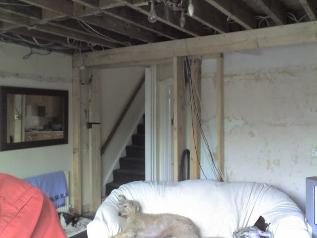

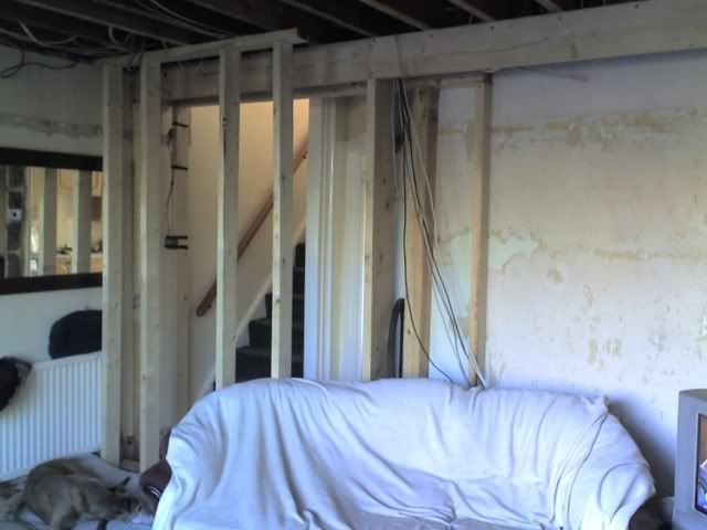

It appears that this wall between the hall and the lounge is not structural.
http://i210.photobucket.com/albums/bb208/drhysted/DSCN2537.jpg
Guess what I'm doing next year?

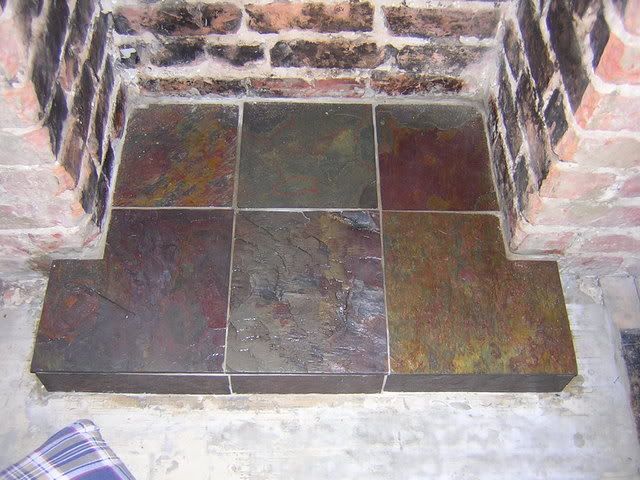

Here's the slate plinth
http://i210.photobucket.com/albums/bb208/drhysted/DSCN2672.jpg
After five coats of sealant I think the slate looks brilliant. Purposefully left the bricks black, I think it creates a brilliant contrast.

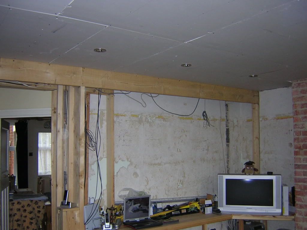

Well a bit of an update for anyone interested.
Got held up trying to find tradesmen that actually want to work.
http://i210.photobucket.com/albums/bb208/drhysted/16-04-08_1757.jpg

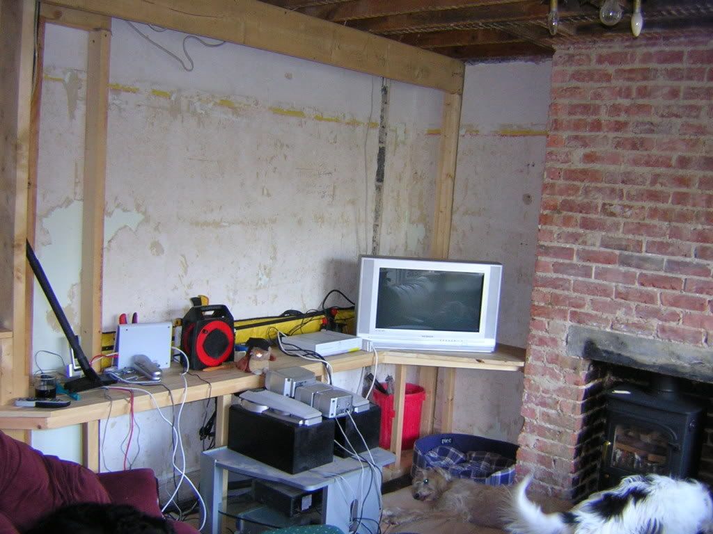

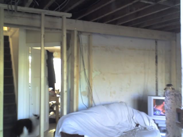

Here we have a new beam which technically isn't needed, but we've got the hot water cylinder above it, and extra water tanks due to the new pumped water supply (capable of delivering 20 litres per minute) ready for when I build the shower room. In front of that is temporary stud work cause the plumber needed access where the acrows were.
http://i210.photobucket.com/albums/bb208/drhysted/16-04-08_1759.jpg
You can see that I've continued the beam across the entire room and will be building custom cabinets to fill in the space (hide the wires) and house the TV, phones, broadband hub ect.
But here is todays project (of which I didn't help at all for once).
http://i210.photobucket.com/albums/bb208/drhysted/16-04-08_0955.jpg
http://i210.photobucket.com/albums/bb208/drhysted/16-04-08_1003.jpg
http://i210.photobucket.com/albums/bb208/drhysted/16-04-08_1106.jpg
http://i210.photobucket.com/albums/bb208/drhysted/16-04-08_1753.jpg
Worst thing is that we can't light it until tomorrow night, cause all the fittings need to cure and settle overnight. Don't care what the outside temperature is tomorrow I'm gonna have a fire!!
Anyway tomorrow I must get the main beam built, glued, screwed and in place cause we are now on our third week with the temporary stud, and she's starting to give me looks.

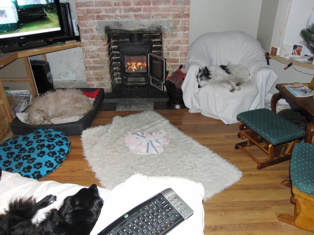

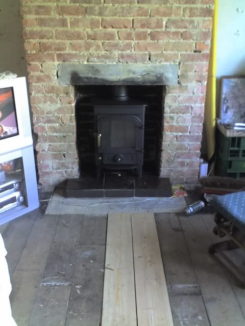

Here we go
http://i210.photobucket.com/albums/bb208/drhysted/18-04-08_1614.jpg
Not burning quite right at the moment, cause the woods a bit big, and it needs a layer of ash (which needs it to burn some more wood).

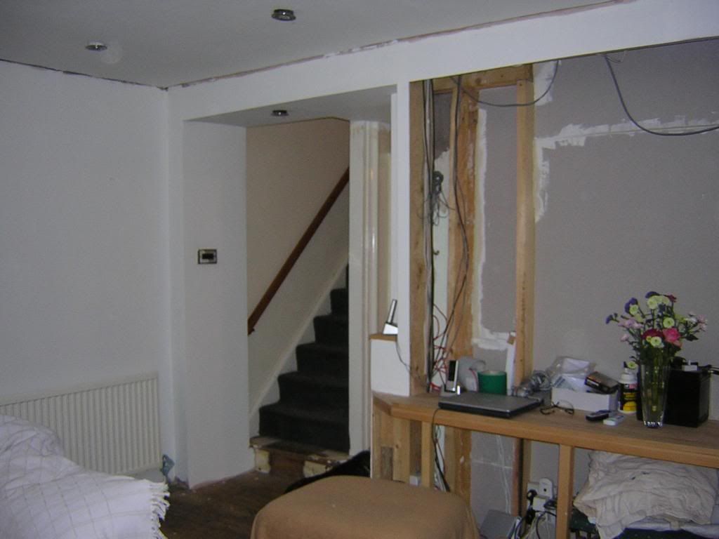

Temporary stud is down and the new beam is complete.
http://i210.photobucket.com/albums/bb208/drhysted/18-04-08_1616.jpg
http://i210.photobucket.com/albums/bb208/drhysted/18-04-08_1615.jpg
Bit of a buttock clenching moment when I took all the supports down, even though I've not removed anything structural and added two new beams (one 8x2 and the other 8x8), you still have to hope you've got it all right.
Nothing happpening for the next three weeks as we've got a builder coming with a new custom made front door (unusual width opening), so looks like I could try for some time off (yeah right)!

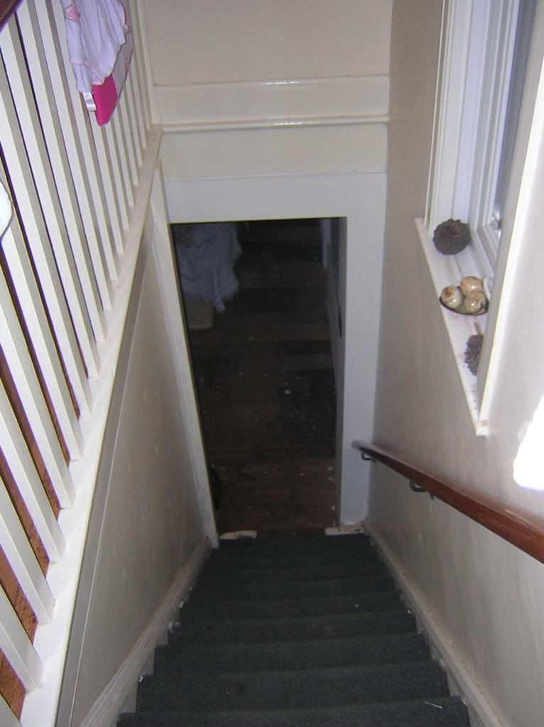

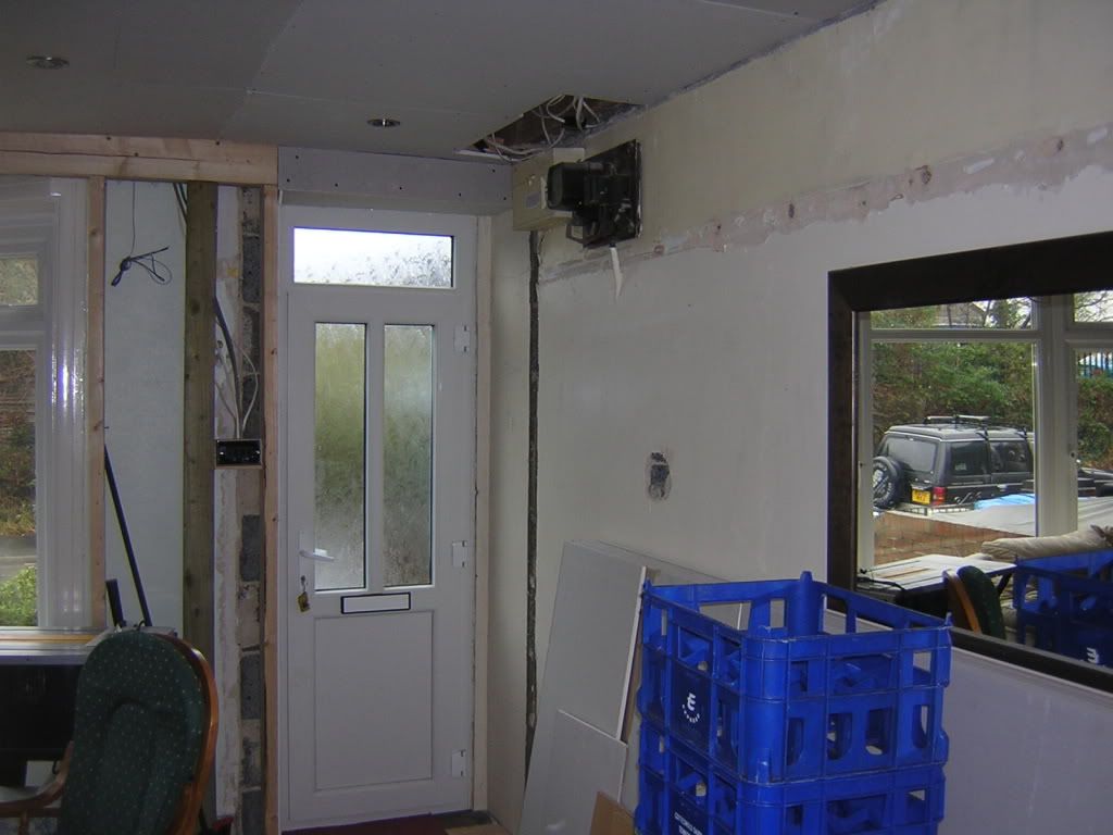

Nice new front door is in (fitted by a builder so I didn't need to lift a finger, thankfully same builder came and did the repairs and filling in of the back wall so one less job form me :D  :D  :D ). Also all the new light fittings are in.
http://i210.photobucket.com/albums/bb208/drhysted/DSCN2807.jpg
As you can see I've sorted out extra support for the bay window. I didn't want to re-level the bay as I'd already repaired the external facia, so the double beam had to have each joist fitted, a proper chippy would have used a chisel, me I used a router but it was still very time consuming.
Now jobs left finish the end wall plasterboarding (with inset shelves), box in the stop cock, build a cupboard around the meter and fuse board, clean up the brick work on the chimney, plaster walls and ceilings, build upper dresser unit and lower cupboard unit. Oh and build shower room. Well wouldn't want a quiet life now would I :devilish:

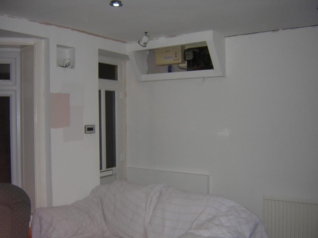

Decided to box the fuseboard at an angle (well I'd framed the cupboard out and my sister turned up and told me it looked awfull and would look much better angled)

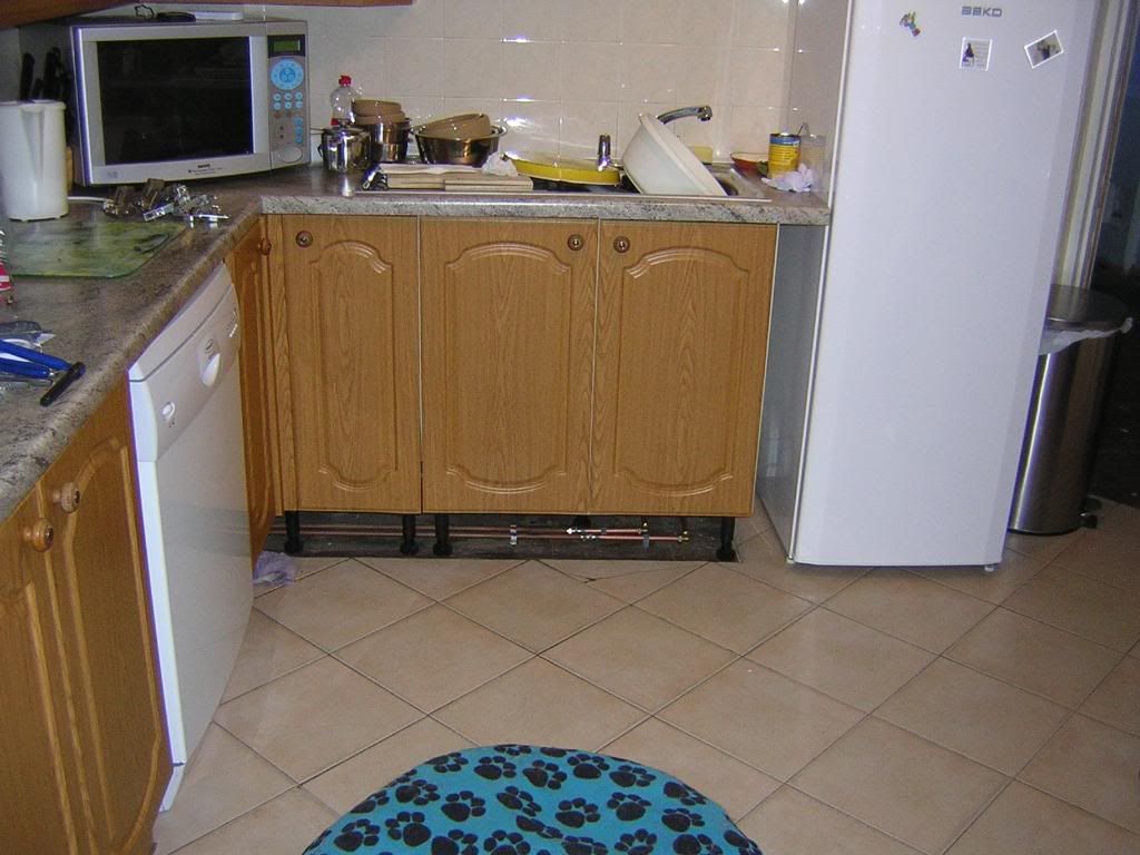

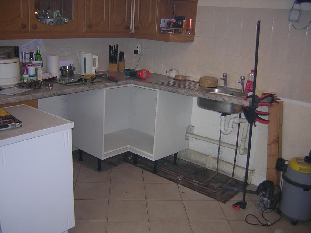

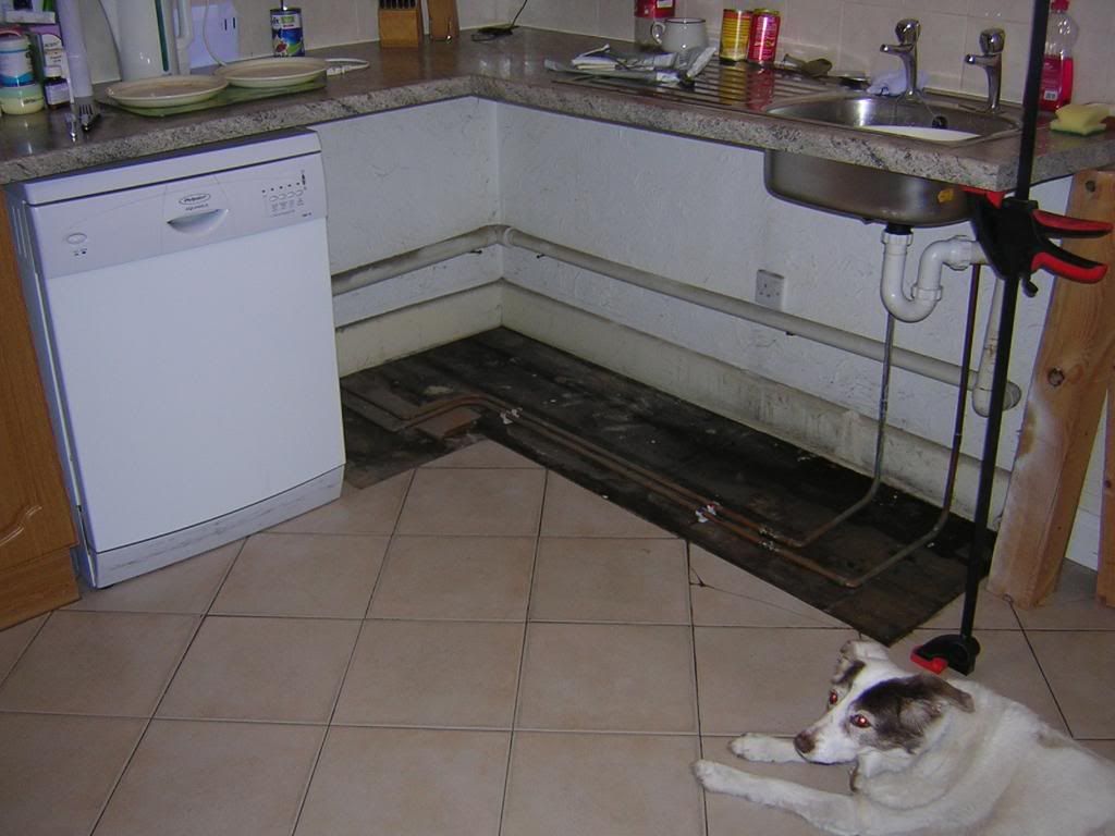

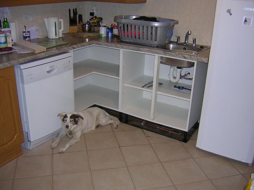

This set of rest days I was going to put up the coving, but a cupboard in the kitchen collapsed, due to poor instalement by the plumber used 13years ago. The hot water pipe was leaking, the drain pipe was leaking. So
http://i210.photobucket.com/albums/bb208/drhysted/DSCN2849.jpg

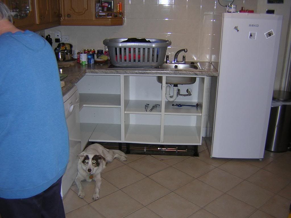

Don't you just love the sink support, not only had the cupboard under the sink rotted out, but the corner unit was damaged as well. Thankfully the floorboards were just covered with a lake, but little penetration.
http://i210.photobucket.com/albums/bb208/drhysted/DSCN2867.jpg
http://i210.photobucket.com/albums/bb208/drhysted/DSCN2870.jpg
http://i210.photobucket.com/albums/bb208/drhysted/DSCN2871.jpg
http://i210.photobucket.com/albums/bb208/drhysted/DSCN2873.jpg
Managed to reuse the doors, which was a good job becasue they don't make them any more, couldn't get a replacement side panel so will just have to live with the white end (not to bad really with the white fridge next to it). I'll probably get some wood and experiment with different stains for the kickboard. But you see before you new hot, cold, and drainage plumbing, with ball valves on the hot and cold lines. New cupboards, new taps, and the result of alot of swearing. Unfortunatley the work has really flared up the arthritis in my hands, and now even holding a steering wheel is painful, but that should calm down in a day or two.
I'd like to point out the plumber that fitted the kitchen (badly) wasn't the plumber who installed the pressurised system last year. The kitchen plumber did the work when we weren't there, the plumber last year had me working as his mate for the week watching his every move (he did a perfect job even with me questioning him all the time).

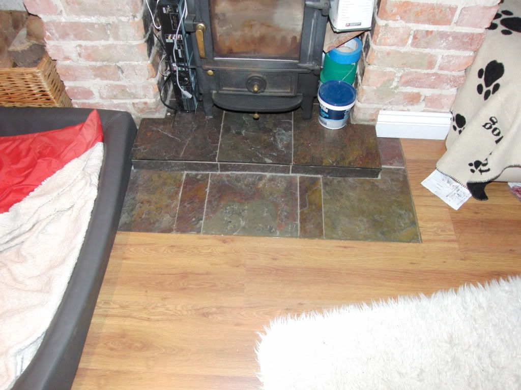

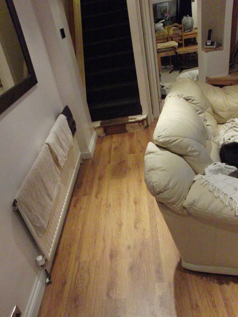

Date: 09-01-2010 17:28:34

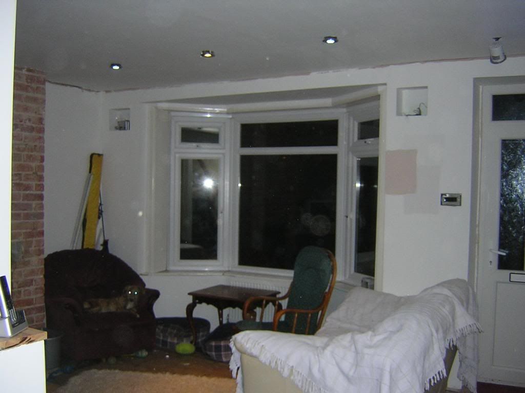

Now some of you long suffering fools will know about this, and be fully aware that I have successfully failed in the two year deadline (some suprise there then). So I thought a little update was in order.
http://i210.photobucket.com/albums/bb208/drhysted/09-12-31-1728.jpg
Look I have a floor.
http://i210.photobucket.com/albums/bb208/drhysted/09-12-31-1730.jpg
And skirting board.
http://i210.photobucket.com/albums/bb208/drhysted/09-12-31-1733.jpg
Really all that's left isclean up the brick work on the chimney, make the cabinets, make and fit the fuseboard door, and make the window surround and sill.

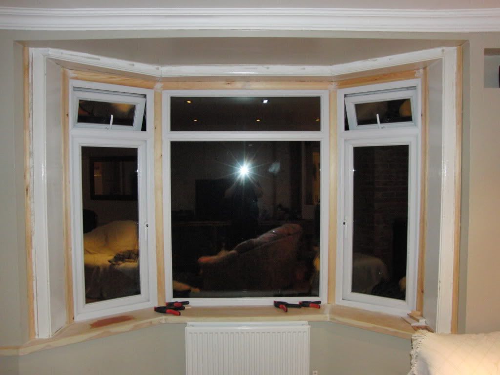

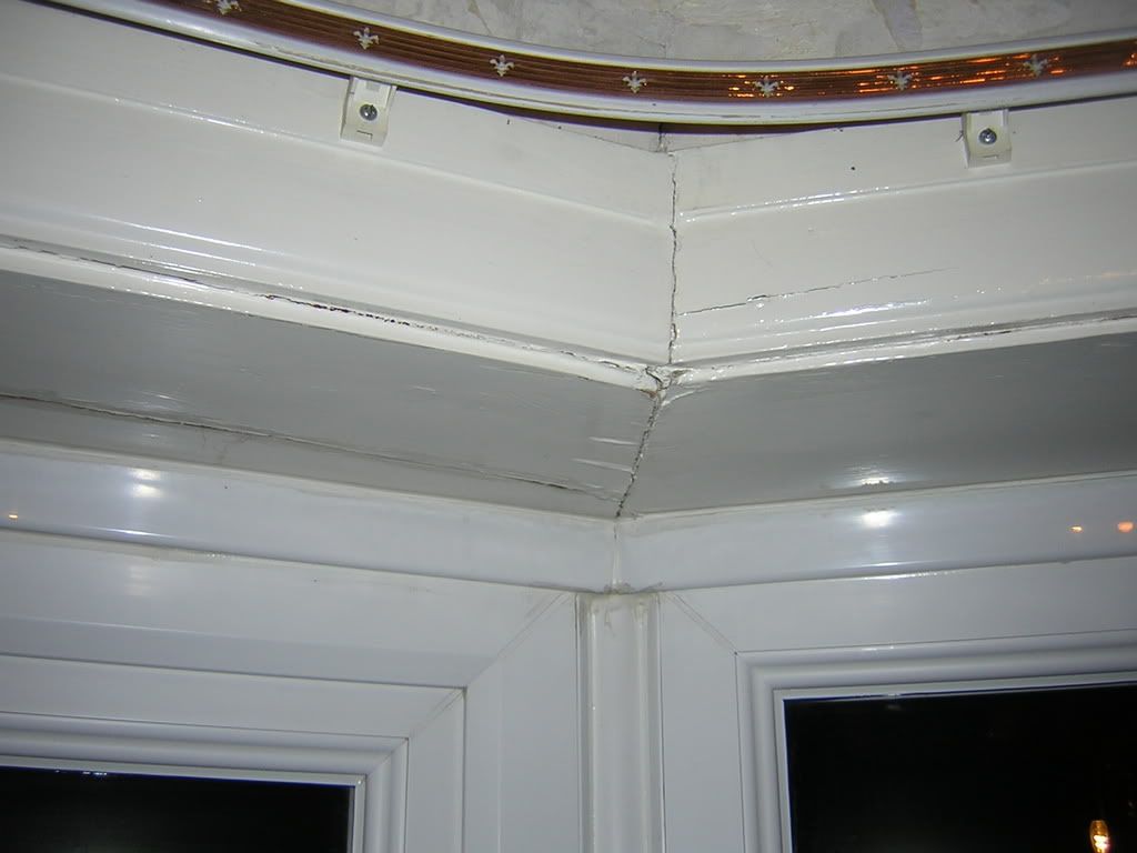

Found out why the bay window dropped half an inch in the centre. The steel inserts were too short for the frame (found this out when I was removing the plastic trim from round the window). I would sat don't use the company we did, but they haven't existed for at least four years now.

Thought I might update this, as I've been doing some work lately.
I have finished laying all the tiles around the fire place (not grouted yet, but I don't want to rush this now do I)

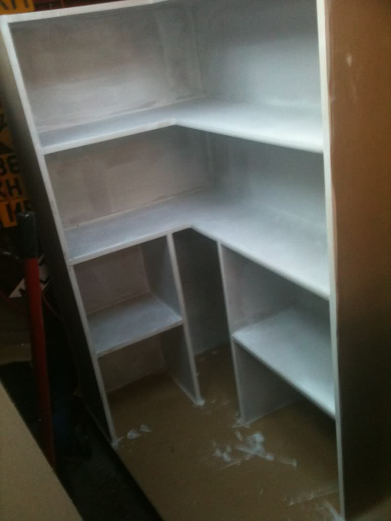

http://i210.photobucket.com/albums/bb208/drhysted/760a806a.jpg
This is the corner unit to go on top of the work top. It's made from MDF (due to cost) so will be painted, at present it's had a quick coat of primer as tomorrow I want to put it in place to see what finishing is needed. After that it's the TV unit that needs building :mad:
